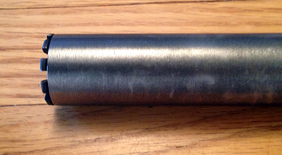

I have an AAC Element 2 and love the suppressor. But..........
I decided to put it in the ultrasonic cleaner after running about 250 rounds of various species of ammo through it.
To my surprise and dismay the finish (paint) on the exterior of the suppressor came off in like 2 minutes!!!
I couldn't believe this thing shed its outer coating so easily in plain simple green and water!
I have read that people use these to clean other brands without incident.
I am wondering if my experience is unusual or this is typical of the AAC product?
Comments please.....

You didn't read enough. Do not put the tube or aluminum or Ti in a sonic cleaner!

The tube is titanium, i am not surprised the finish came off.
Titanium should not be placed in an US.

Deer you can fix it or send it in. Mine is The pre 2 element and the finish wasn't that good anyway and they nickel coated them then. I gunkoted it and it's held up great and much better. They are now TI tubes and I thought they went to cerakote but still can't pass the sonic test. :mrgreen:
Here was mine naked. :oops: :D
(Looking for a finished pic now.)

You could send it in for a finish if you wanted. I would just leave the finish off. No big deal.

I just did that to a prototype Spectre. I was using Slip 2000 750 de-greaser. A good portion of the black oxide came off (must have been bad surface prep as the production Spectre done at the same time was fine). I ended up tossing it in with the last round of 9mm brass in the stainless media tumbling set up to see what it would do.
It took off pretty much the rest. I might just leave it, or maybe I should moly it. not sure yet.
I will say that we had a guy ruin his Trident with "mean green". It pretty much removed the anodizing.

Ultrasonics cause cavitation just like props do. They will eat steel if you leave it in them long enough.
Not surprised at all.
