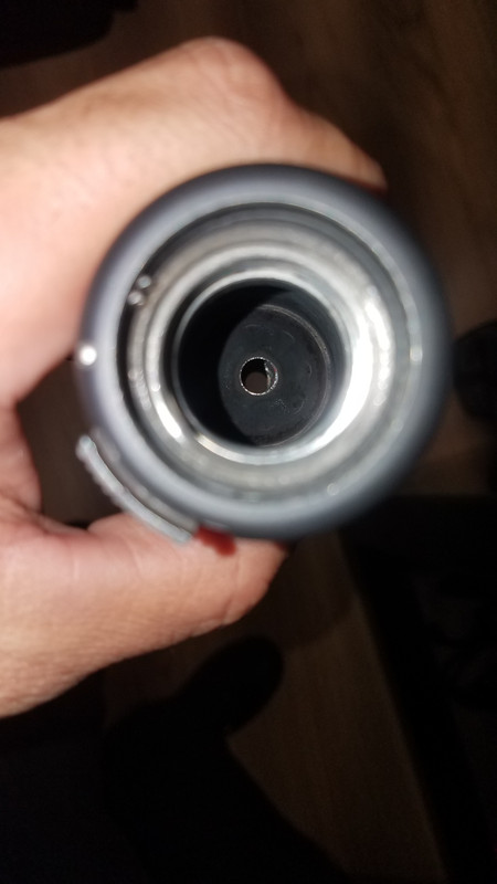

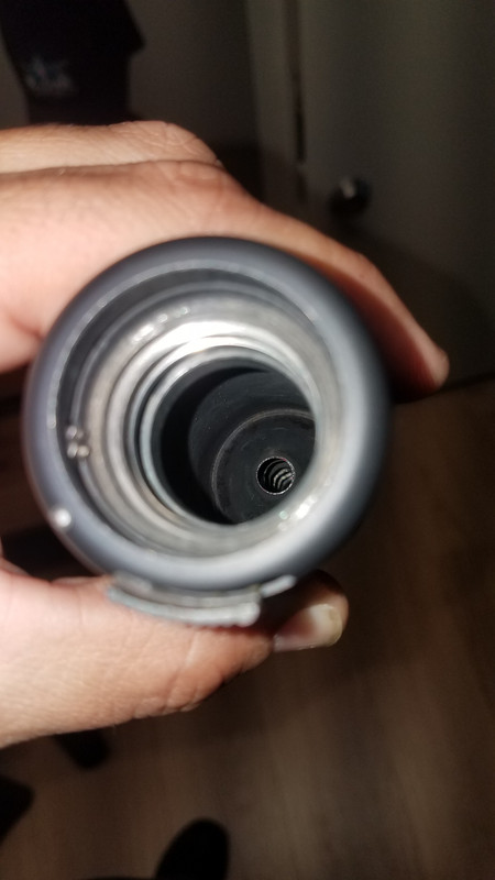

I now know the M4-2000 is not a multi caliber can after reading a few posts here. But long story short...I bought the m4-2000 in may 2017 thinking it was a 6.8/556 can. Got approved mid 2018. spent most of 2018 shooting 556 with it without issue. Then I finally decide to try it on the 6.8. :( Nothing too bad...bullet exited without an endcap strike but was tumbling and was 10in high and 4in left at 10yds :) You can see some baffle damage but nothing else. I contact AAC and sent it in. They sent it back saying all they found was an issue with the latch. No one from AAC has told me I screwed up and not to shoot 6.8 thru it again, nor did they address the baffle damage.
I guess my 2 questions are...
1) my can is marked 556. I should not shoot 6.8 correct? :D
2) should I be concerned with the baffle damage?
ImageImageImageupload picImageImage

With a POI shift of 10 inches, the baffles are disrupting the bullet---badly. I also note some keyholing in the top of your target. My assessment, You're going to blow it up if you continue doing it.

And yeah, bullet rubbed the baffles, and came out tumbling. No end cap strike luckily. I put 3- 6.8 rounds though it before realizing something bad was happening... one at 25yds which was off paper...next 2 at 10yrs...which you see keyholed.
Can has been sent in to ACC and sent back...they recoated the exterior and said my baffles were within spec. Stated that if the baffles were out of spec they would have replaced the core.
Should I be concerned with that damage to the baffles or take aac at their word that they are within spec?
If they said they checked it and it was OK, then I suspect they checked it and it's ok... for 5.56x45.

I'm not looking to make a big deal out of it with either AAC or Silencershop. Just want to be sure I didn't eff it up in terms of accuracy and suppression. You can see the damage if you click on the pics and then zoom in. That was my biggest concern... that the baffles were ok.

True that you didn't do the baffles any favors, but try it and see how it shoots then go from there.

Don't feel bad.. I can see how you read it as both.
Usually I make it a practice to check diameter of opening and if it is aligned properly (bad threads can give baffle strikes)
Fortunately for you it could have been a more expensive learning experience.
