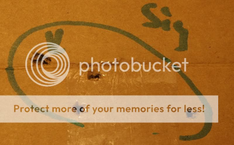

So, I bought an Aviator, it was approved -early 2009 I think- and I let my 7yr old son shoot it around the house most of the time and hadn't noticed a problem -I thought he was a worse shot than he is . . October 2009 - Once I finally joined a range and put it on paper I found it was hitting the paper sideways and low with both P22s and my Ruger 22/45 with a Tac upper. So , I stopped by Tornado Tech. and had Mike look at it, he said to send it back to AAC and to tell Mike Mers it was a mount issue. Sure enough, Mr. Mers called me to inform me it was a issue with the can and that I could upgrade to a Prodigy, Element or keep another Aviator. I opted to go with the Prodigy since I had bought 3 QD mounts, P22, Sig Mosquito and a 1/2x28 adapter.
Waited for the Form 3 to my dealer.
Of course, the Sheriff decided to stop signing for a few months and it was finally approved in October 2010. I promptly took it to the range the first day -October 27th 2010-I had it and found this.
Shot at 21ft. quick, and the more I shot the more pissed off I got.
Top left is a Ruger 22/45, no can, top right W/ Prodigy - 2 out of 10 hit sideways, Bottom left W/ SWR Spectre, bottom right W/TAC65.
Top left is P22#1 with an AAC QD Adapter and no can, top right W Prodigy - 8 out of 10 hit sideways, bottom left W/ SWR Spectre, bottom right W/ TAC65.
Top left is P22#2 with a GemTech adapter and no can, top right W Prodigy - 6 out of 10 hit sideways, bottom left W/ SWR Spectre, bottom right W/ TAC65.

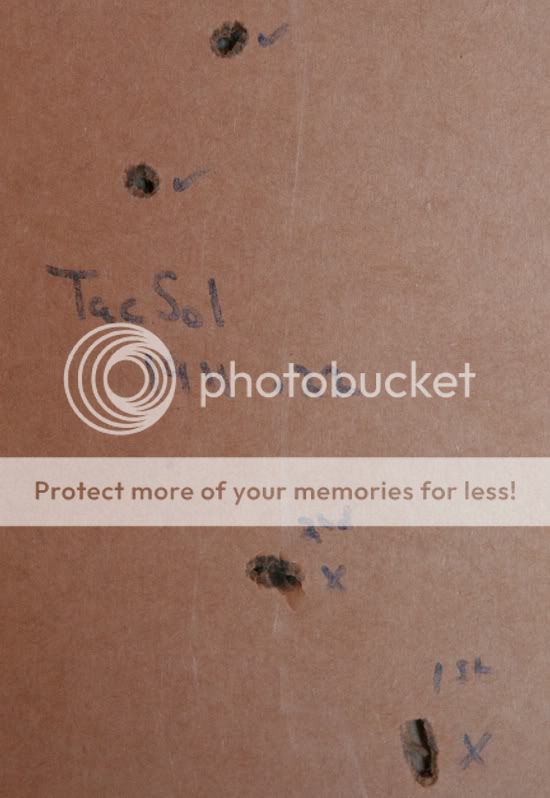

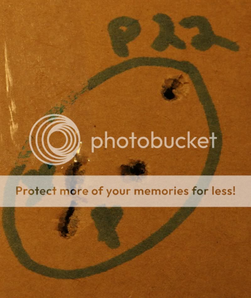

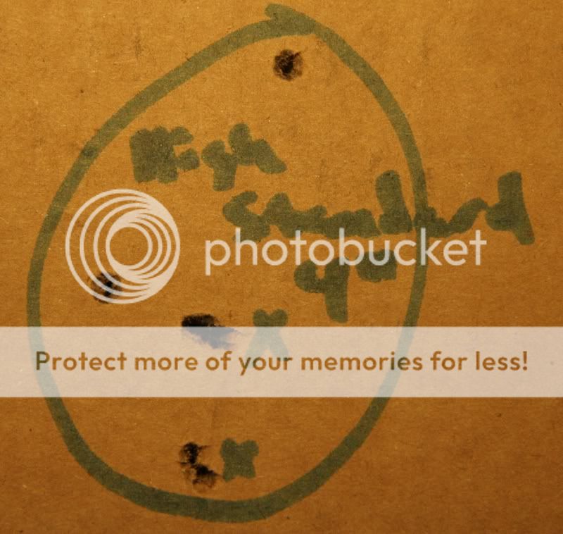

Pistol Key-holing samples.
All pistols tape tested and are not getting end cap or baffle strikes Threading is good and concentric:
TacSol 1911 .22 Conversion.. 25% keyholed with an additional off round hit.
P-22 with AAC fast attach adapter This has 50% keyholed at 20' full sideways impact.
Sig .22 Conversion also had a oblong partial keyhole impact .. Best of the 4 4 shot test groups.
High Standard with 4" barrel .. this has 2 keyholed
The P-22 has the shortest barrel, the High Standard is next at 4" The Sig Has a 4.5" but the thread adapter extends it to about 5". The TacSol 1911 conversion kit has a 5" barrel.
The "Bad" shots were the first and second shots. Apparently barrel length seems to be the significant factor causing more FRP with the shorter barrels..
The POI shift is BAD on the P-22 with the shots WAY off to the lower right.

Pics of the test shots 4 shots per pistol per target and 4 shots with the 2 rifles on one target at the end.
The SIG had 2 fully keyholed in my first test the day before as reported earlier, but not yesterday. It got only 1.
Summery... It appears that the First run of Gen 2 cores may have the instability issue. If you have an early production Prodigy Gen II core test it and see. IF you have different results please post them.. The Clean vs dirty resulted in no or a slight increase of the instability in my testing. FRP was less in the clean core. It seems the FRP is no the cause but probably rather the increased muzzle pressure.
