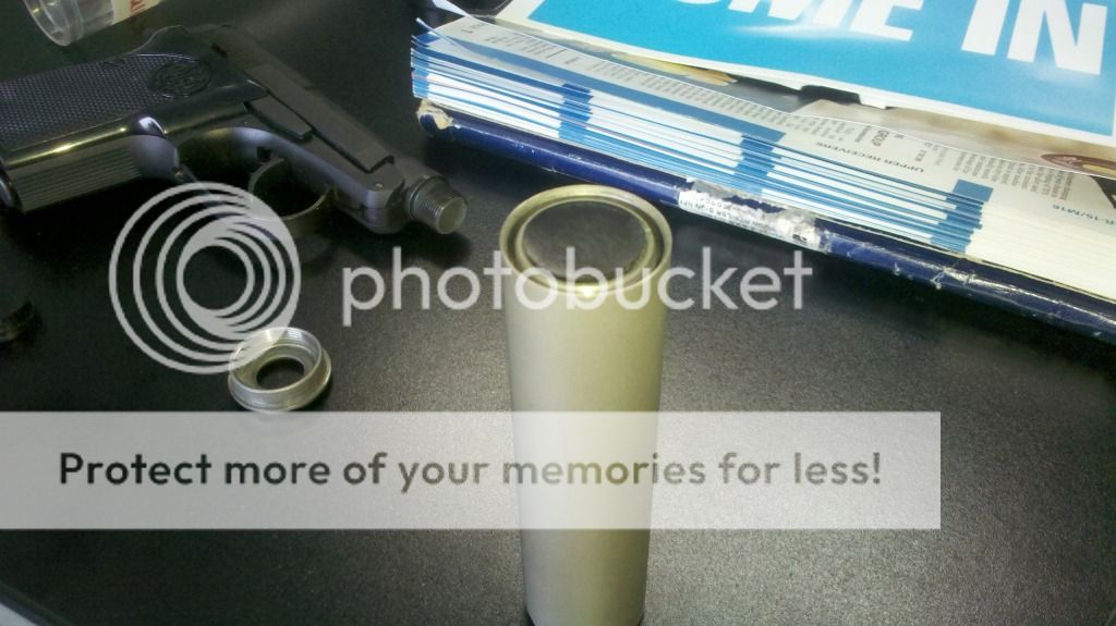

Well got my materials... never played with wipes before this stuff looks sturdy..
I can shoot .380 thru this in the nano without the center punched punched out?

blacklabelop wrote:Well got my materials... never played with wipes before this stuff looks sturdy..
If it's polyurethane with a durometer rating of 80A and is 1/4" then yes, you can shoot .380 thru without a center hole punched in the wipe.
If you're using 1/8" material remember to use two wipes to equal the 1/4" wipe.
Persoanlly I prefer a single 1/4" wipe.

Well looks likes the wipes fit..
now I just gotta think if I want to try it with a .22.

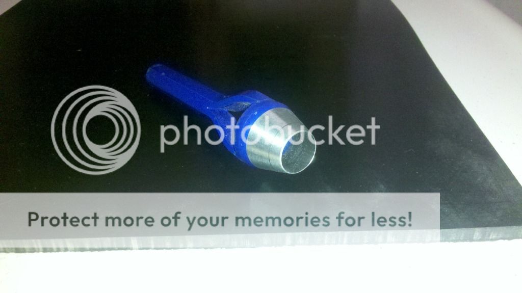

Well, the post was a bit old but had the info I was looking for. Punch and sheet arrived today. I followed the instructions with the punch stating not to use a steel hammer. The punch just bounced off the poly sheet material. Is it just me?

primaryind wrote:Well, the post was a bit old but had the info I was looking for. Punch and sheet arrived today. I followed the instructions with the punch stating not to use a steel hammer. The punch just bounced off the poly sheet material. Is it just me?
I just put a piece of wood through it and then use a press to cut the wipes. A lot smoother than trying to hammer through 1/4" sheet. The 1/8" worked fine with just a hammer

Post by wishbone »
Mine cut through like butter with a hammer, no problem. In fact I probably shouldn't have done it on the floor because I didn't expect it to go through so easily. Just my two cents.
